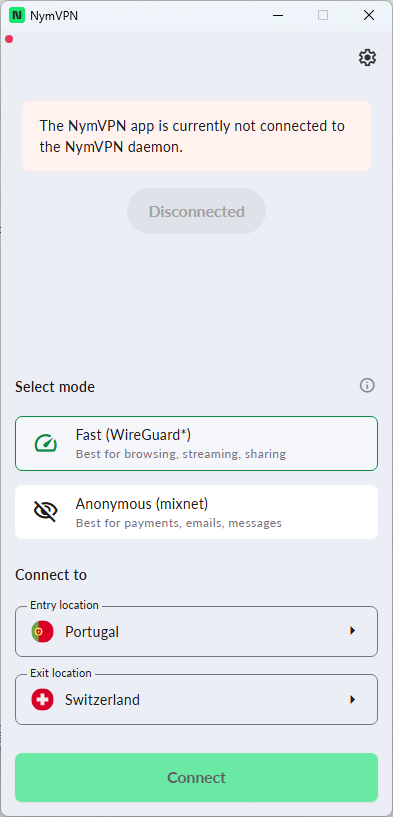

Step 1: check if your app is connected to the daemon

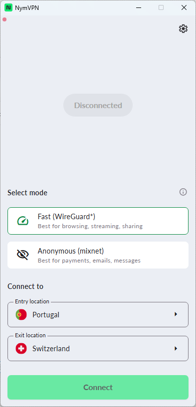

If you see a red dot in the top left of the NymVPN app or a "daemon not connected" message, the app and daemon are not connected.
