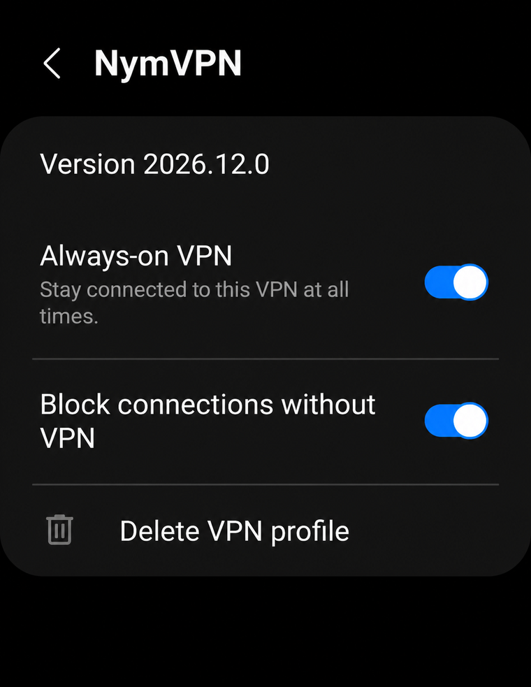

- Open the NymVPN app on Android.
- Go to Settings and open Kill switch.
- When prompted, open Android's VPN settings for NymVPN.
- Enable Always-on VPN.
- Enable Block connections without VPN on the same screen.
With both on, your device comes up protected after every reboot, stays protected if the tunnel drops, and stops showing the disconnect notification.
What the two settings do
These are separate Android system settings that work together, on top of NymVPN's own always-on kill switch (which needs no setup). Always-on VPN starts NymVPN automatically, including after a reboot, and keeps the tunnel open, but on its own it still lets traffic through your normal connection if the tunnel drops. Block connections without VPN (lockdown mode) closes that gap: whenever the tunnel is down for any reason, no traffic leaves your device at all.

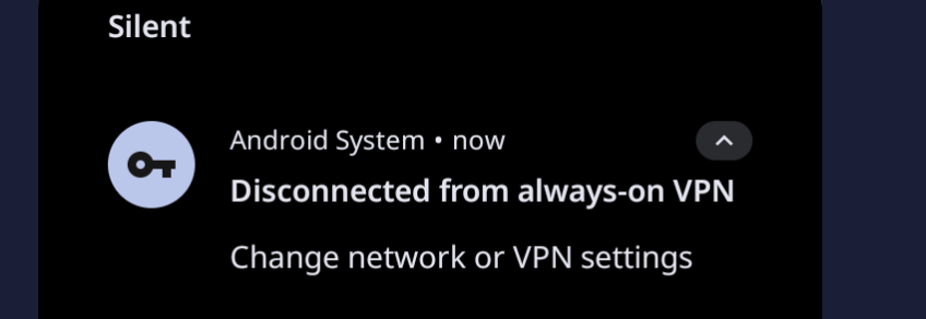

The "Disconnected from always-on VPN" notification
If you enable Always-on VPN but leave Block connections without VPN off, Android shows this notification whenever the tunnel briefly drops. It comes from Android, not NymVPN, and means your device was online without the VPN for a moment. Turn on Block connections without VPN and the gap, and the notification, disappear.
