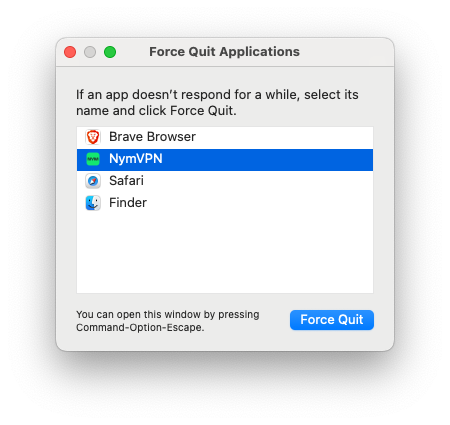

2. Quit NymVPN
In the app menu, select Quit NymVPN, and confirm when prompted.

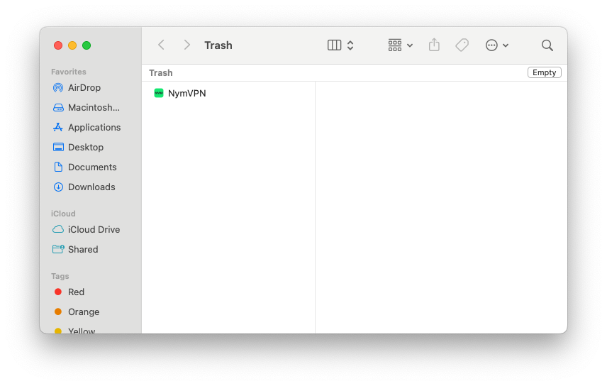

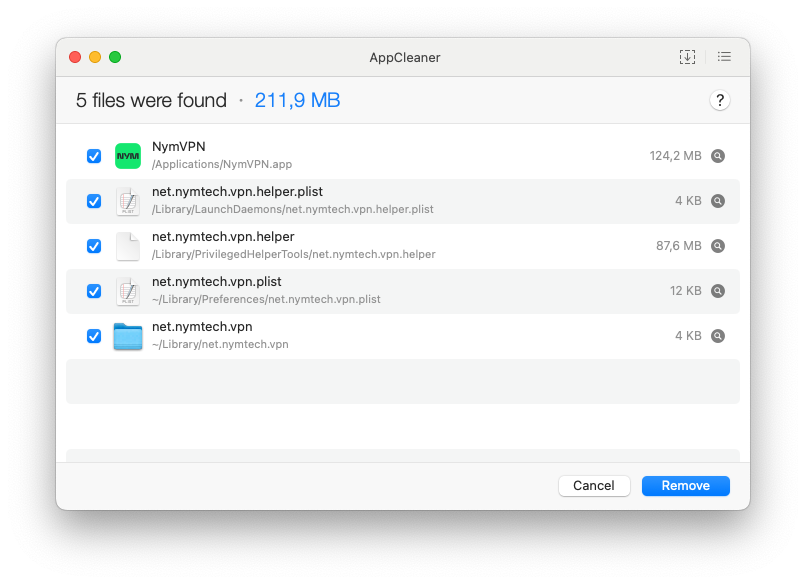

3. Remove NymVPN and associated files
Use App Cleaner or an equivalent uninstaller tool to remove NymVPN and any related files. Afterward, empty your Trash.

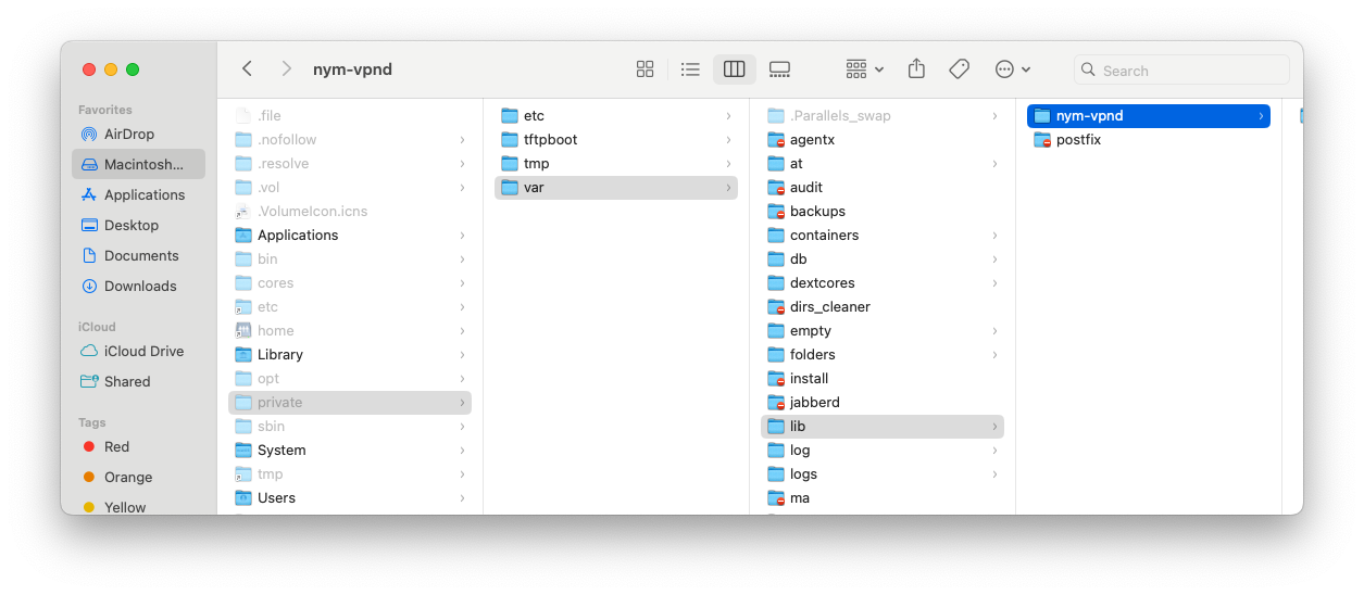

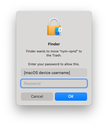

6. Delete remaining files via terminal
Open Terminal and enter the following commands one at a time. You’ll be asked to confirm with your admin password.
sudo rm -rf /var/lib/nym-vpnd/
sudo rm -rf /etc/nym/
sudo rm -rf /var/run/nym-vpn.sock
sudo sfltool resetbtmIf you prefer to delete files manually, reveal hidden folders in Finder by pressing Cmd + Shift + . and navigate to the paths above.

1. Disconnect and quit NymVPN
2. Delete the NymVPN app
