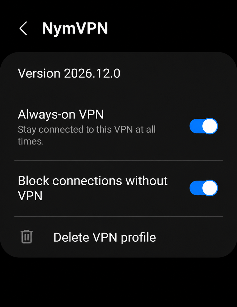

- Open the NymVPN app on Android.
- Go to Settings and open the Kill switch option.
- When prompted, open Android's VPN settings for NymVPN.
- Enable Always-on VPN.
- Enable Block connections without VPN on the same screen.
With both enabled, your device comes up protected after every reboot, stays protected if the tunnel drops, and stops showing the disconnect notification.

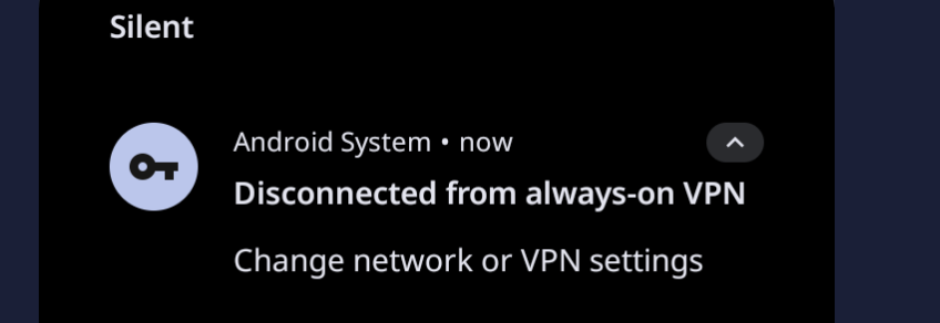

About the "Disconnected from always-on VPN" notification
If you turn on Always-on VPN but leave Block connections without VPN off, Android shows a "Disconnected from always-on VPN" notification whenever the tunnel briefly drops. That message comes from Android, not NymVPN, and it means your device is online without the VPN for a moment. Enabling Block connections without VPN closes that gap, so there is nothing left to warn about and the notification stops.
